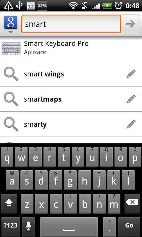

Hello, I have created a GingerBread keyboard skin (hdpi only - I am too lazy
). Is there any way I could use mod-key-background for the space and comma buttons (so every button on the lowest line would have the same background)? Without that option it looks a bit weird...
- device.png (54.66 KiB) Viewed 11013 times

Hi, I have added this into my skins folder many times and it doesn't show up as a skin previewer.martinpelant wrote:Hello, I have created a GingerBread keyboard skin (hdpi only - I am too lazy). Is there any way I could use mod-key-background for the space and comma buttons (so every button on the lowest line would have the same background)? Without that option it looks a bit weird...
